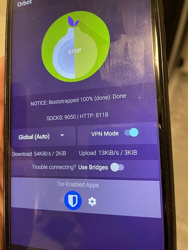

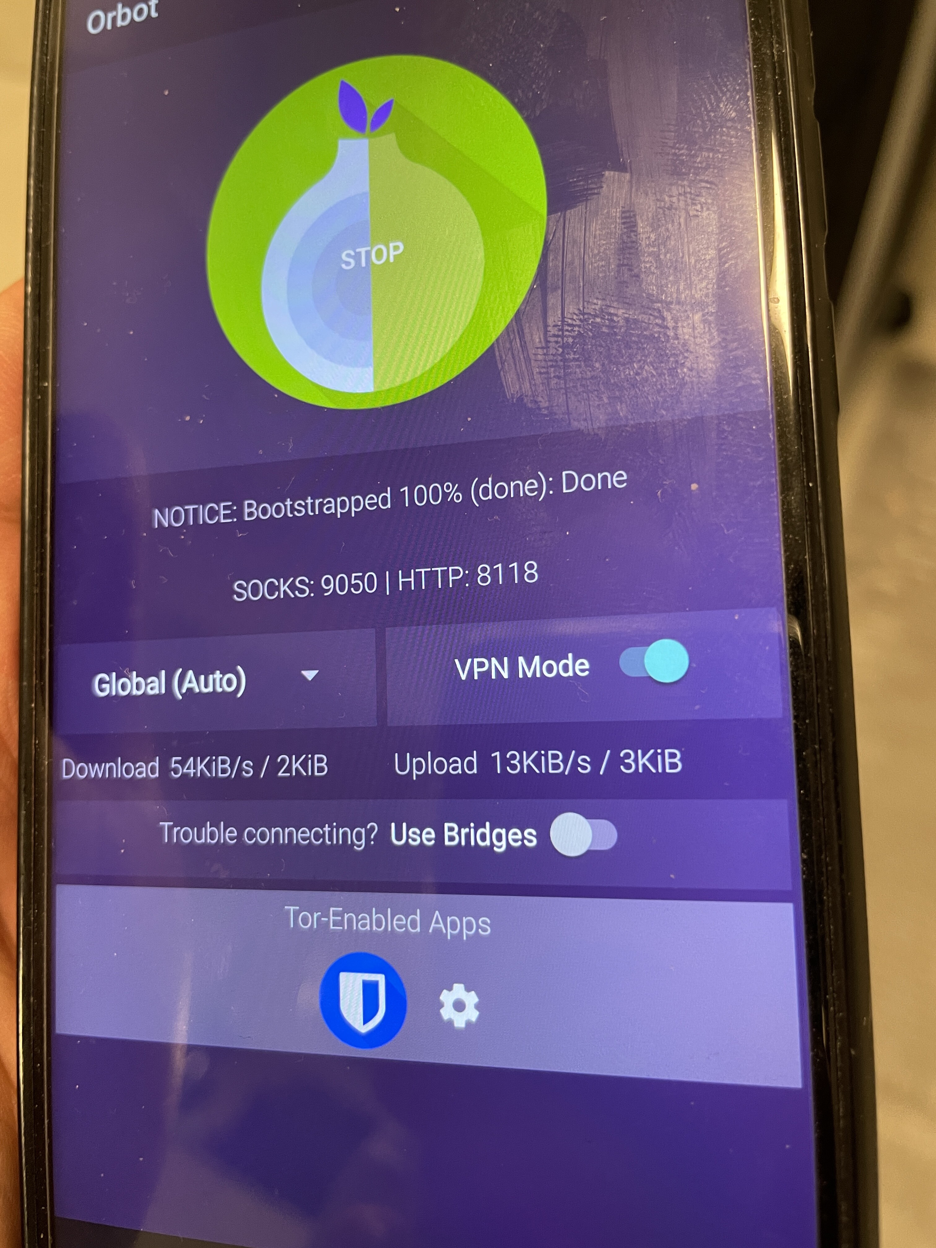

I did that and got the same error messagešŸ¤¦ā€ā™‚ļø
so from Tor browser you could enter in your vaultwarden?
then is something wrong with your mobile and Orbot.
Try restarting orbot.
Force close bitwarden
start over with orbot again, sometimes is doing this orbot
I have vpn on my router and use calyxos my phone. I have tried many times to turn it off and on all different ways. Its annoying …
yeah from tor absolutely no problem on phone or computer
I think you answer yourself to your issue…
connection reset is when your tor connection is not 100% bootstrapped. try again with a new session.
Same error soon I have to go to mental hospital- what the hell is going on …
Just gave up on this one.
