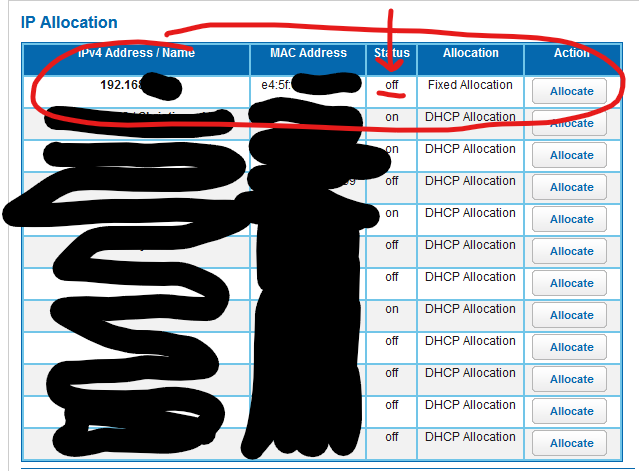

I assigned it a fixed IPv4 and it shows up in the device list as off.
Router is at&t BGW210
Any other suggestions? Still cannot connect to my node.
