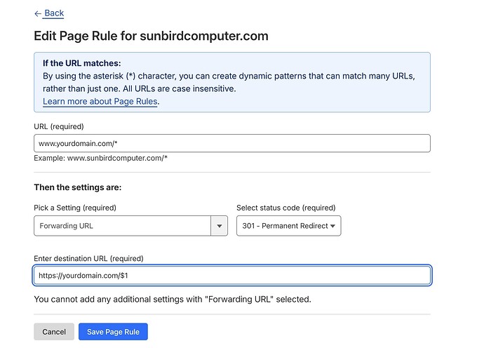

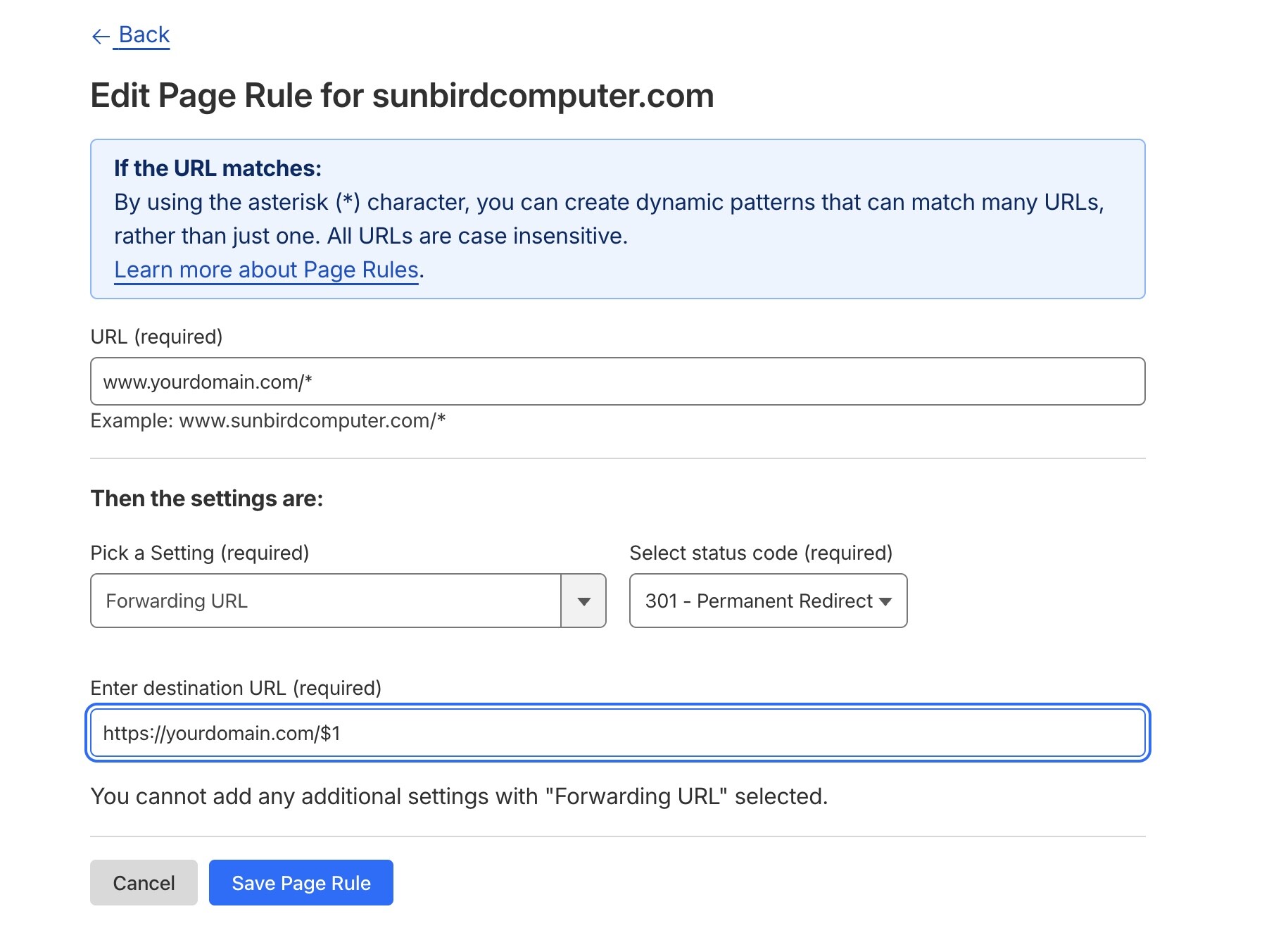

As for Cloudflare I should of specified the rule I just used Page Rules instead of Published Application Routes, I found that easier– it may not be required but I found it helps for redirecting any subdomains as well as just: www.yourdomain and yourdomain without the www. to resolve it reliably as shown below (the dollar sign is a backreference/wild card that catches anything after)… You’ll also want to make sure your nameservers are set for your domain to point to Cloudflare…
I’m always happy to help ppl set things up though and make this run easier, I’ll message you @nicetime with my contact here on the forum now, and also am on Discord where I recommend reaching out in the support ticketing Discord has now where you go General Support > New Post to make a nice thread to consolidate issues, or making a support post somewhere in Cloudfare/domain registrar help stuff if it’s more related to that for anyone else who finds this just because forum support sometimes gets cluttered and is lower bitrate :high_voltage:
