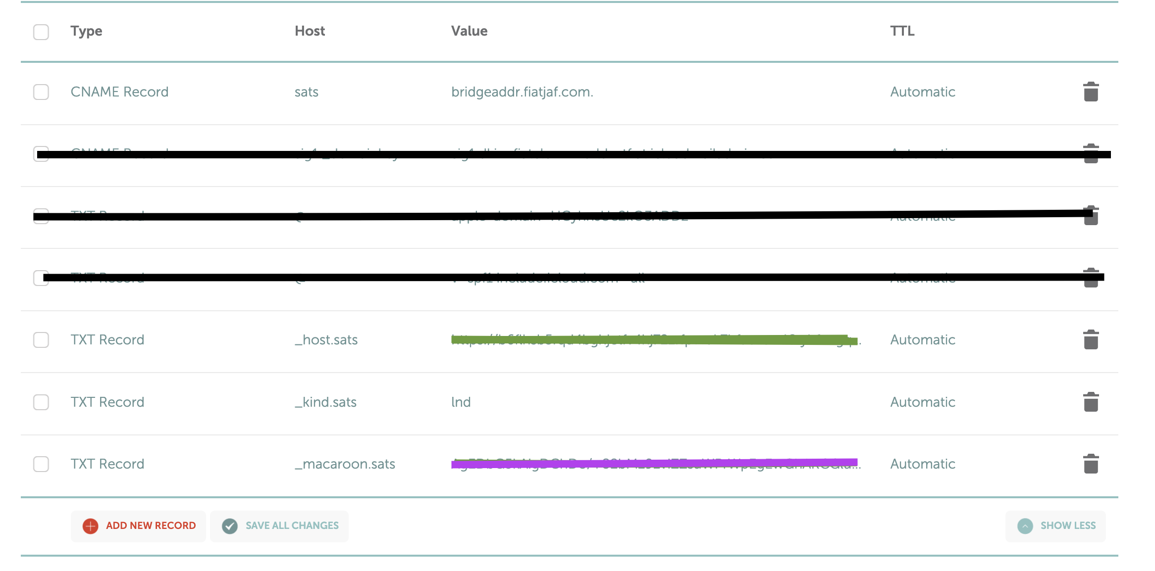

  2. Create the DNS records
    Each domain provider is different but you’ll need to create 4 records.
    For the CNAME record, enter @ for the host, and bridgeaddr.fiatjaf.com for the value.
    For one of the TXT records, enter _host for the host , and your node’s REST address for the value, https://toraddress.onion:8080
    For the second TXT record, _kind and lnd
    And for the third TXT record: _macaroon and the macaroon you just created, macroongibberish=
Screenshot below from my config using Namecheap. The text obscured in green is the tor address for the node (https://toraddress.onion:8080) and purple is the macaroon (macroongibberish=)

To do that, the CNAME record should use whatever you want your subdomain to be called under the Host field. For this example we’ll use sats
Then the rest of the TXT records hosts will need to have .sats after each host.
All values remain the same.
