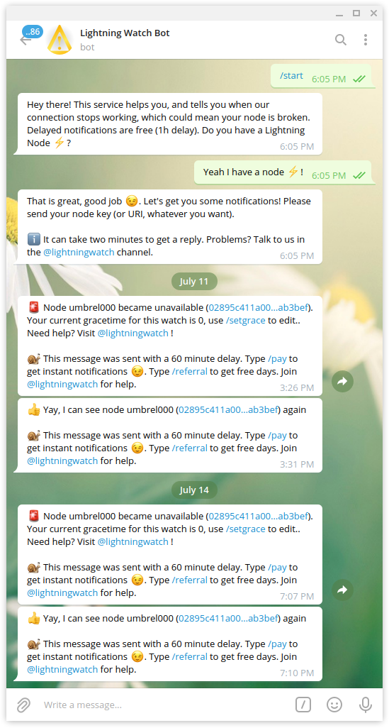

Check out Telegram: Contact @lightningwatchbot
I set it up a while back. Pretty much forgot about it since my umbrel node is so rarely offline. Checked just now and did see that it detected the time where I intentionally shutdown my node for some maintenance. Now if I just figure out how to prioritize these Telegram notifications over all the other noise, the service could be very useful.

Awesome. How often does it check?
Don’t quote me on this, I’m probably wrong. Offhand, I think once an hour, for free. They have an option to pay for instant notification(s). I tried their pay-to-monitor service. It was a little pricey as I recall. It worked; got notification within like 3 seconds when I intentionally offlined my node. I have no needs (yet) for that level of monitoring, so stopped paying for it. It automatically converted back to the free version and the hourly notifications worked perfectly once again.
