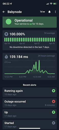

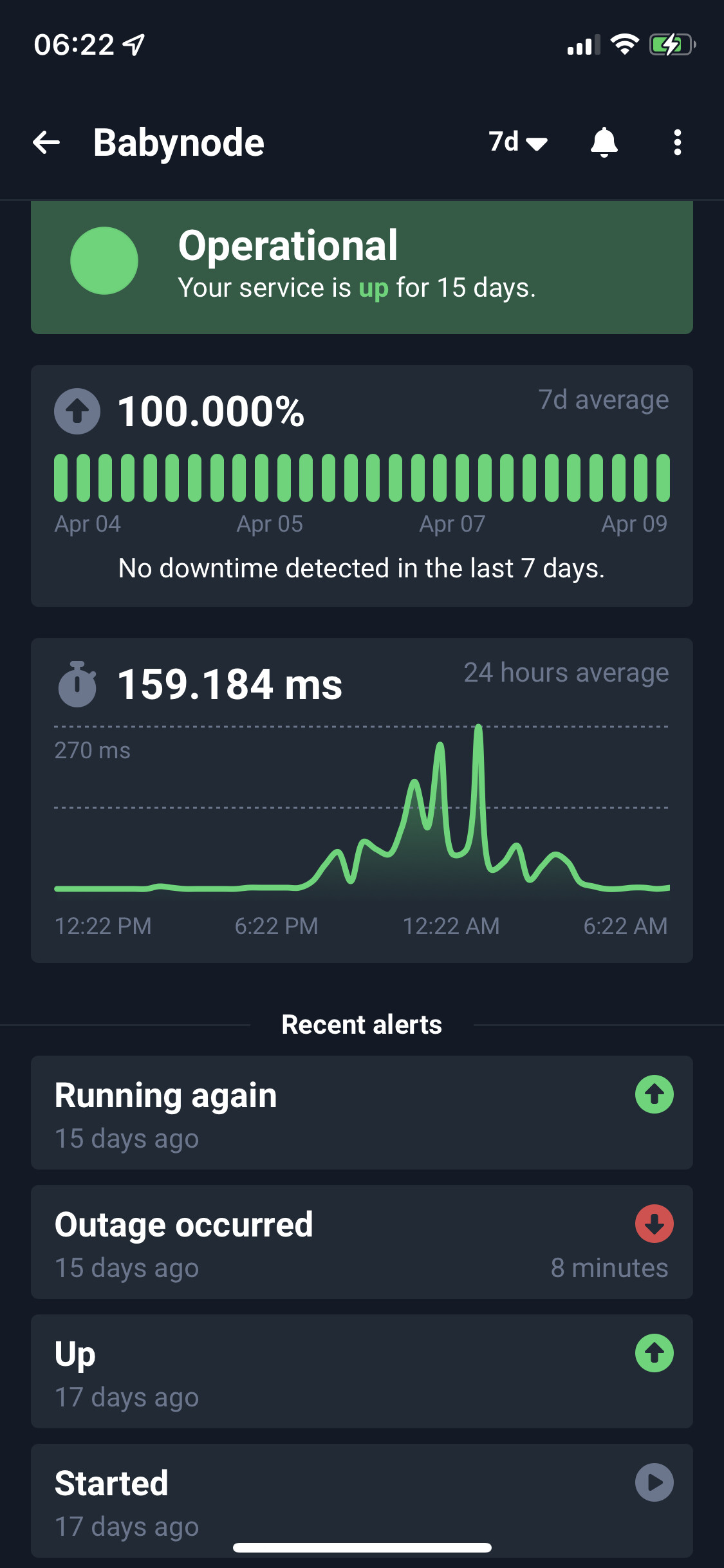

I am using uptimerobot to ping my router and bos to tell me if my node crashes and msg me in telegram. Case 1 is for internet disconnection case 2 for other node problems
What is “bos”?
Hmm interesting. Could you please share a bit more about your setup? Is this bos installed in the umbrel or on another machine? How do you send a Telegram message when it is down?
I will help you better later today. Just turned off my pc and got to bed. Basically bos msg me by telegram if the node got offline and I can always check if it’s all right sending it a command like /version or any other command. The only case it doesn’t works is when my internet gets off and it can’t send me a msg for obvious reasons. I’m that case I use the uptimebot to check my ip every 5 minutes and msg me if it’s offline
Using bos in other machine from outside of my network would be the best choice but its not an option for me so used those little tricks and it works
It is installed in my node
