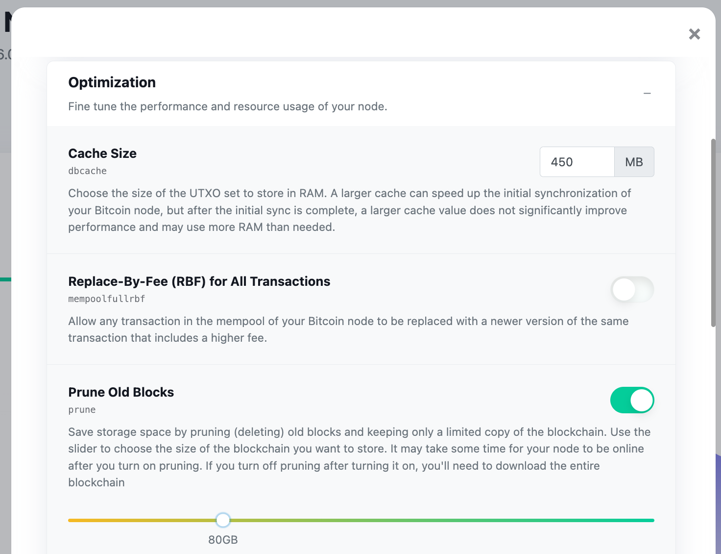

Hi @DuneCruzade We’ve got two good options for you here:
  1. With your current installation, you can choose to run Bitcoin Core as a pruned node. You can find this under advanced settings after clicking the 3 dots in the top-right corner of the app. Set this to be less than the amount of space allocated to your Umbrel instance, and then press ‘SAVE AND RESTART BITCOIN NODE’ at the bottom of the menu.
  2. Otherwise, if you would like to use your external SSD, you can delete your current instance (simply delete the main umbrel directory), and then you can reinstall umbrelOS on your external SSD with this command: curl -L https://umbrel.sh | bash -s -- --install-path path/to/external/drive

I used a 4TB drive, but I did look at the umbrel-bitcoin.conf file and its set to prune=0 which is the whole blockchain. so I would find out where you want to prune it. Some set it at 2000 (2GB) other say 5000 (5GB) should be a good minimum size.
