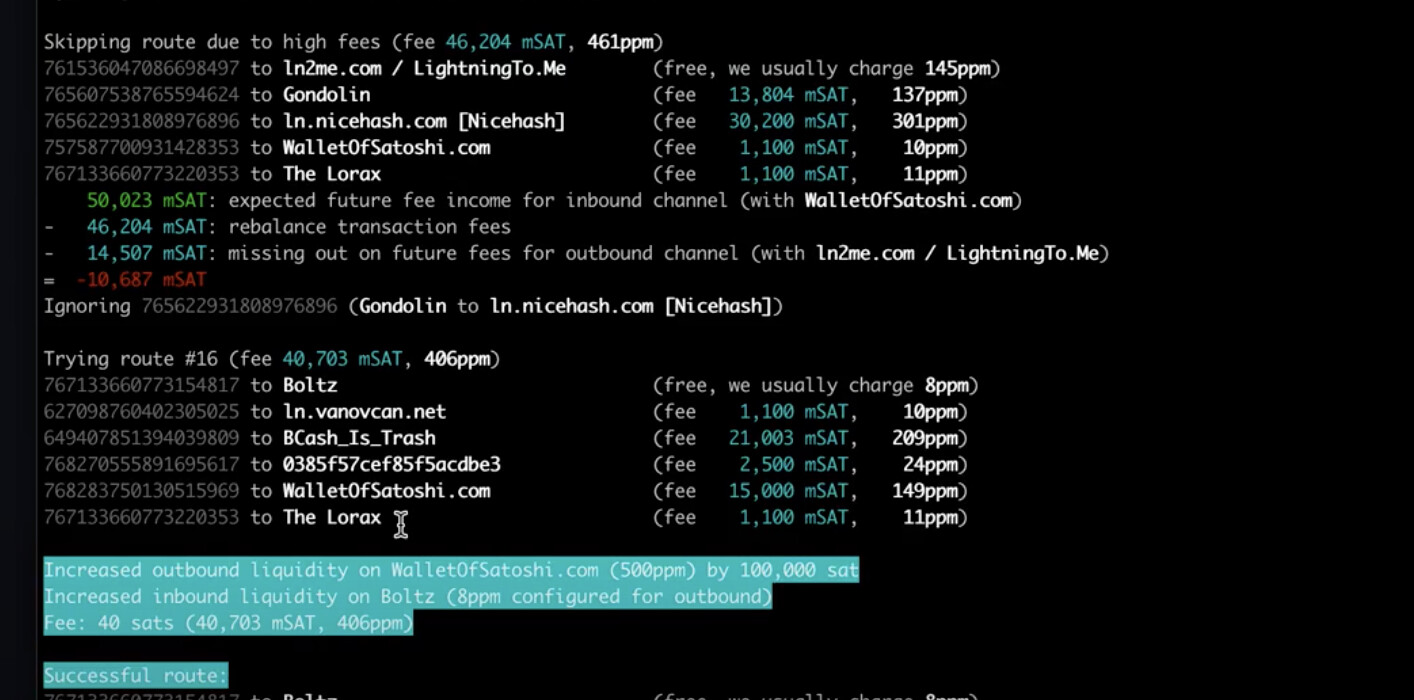

As you likely already know, rebalancing through Thunderhub or RTL is time consuming, and doesn’t work half the time. You have to try 20 different channels, at different prices, and different amounts, to get 1 rebalance to work.
There are lots of rebalancing scripts that will “probe” and try different routes for you, including Balance of Satoshis. But as far as I know, they don’t consider profitability!
Rebalance-LND is smarter. It takes into consideration both how much you’ll earn if the sats are re-routed, as well as how much you’re giving up in routing fees by sending the sats from another channel.
(Note the 2X profit rate on the route, within 1 hour)
This is a pretty big deal… it saves a ton of time, plus, it makes sure that you never rebalance in a way that would lose you money:

Hit “enter” and watch the script work:
Immediately, you will see it start trying routes, including calculating the profit or loss from each of the attempted routes. Brilliant!
If successful, you will see a lot of blue text which will tell you how much you rebalanced, and for how much, and through which route.
