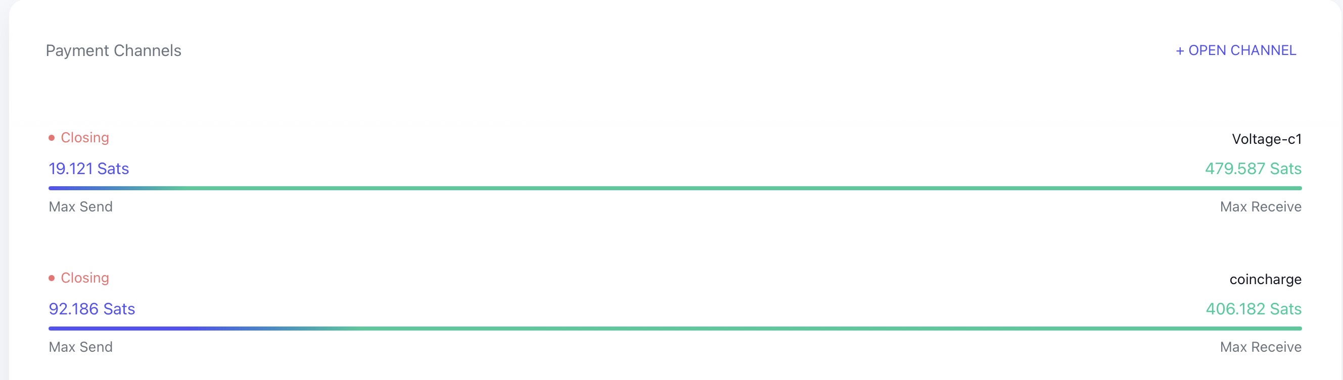

Have a simila issue:
“total_limbo_balance”: “111307”,
“pending _open_channels”: ,
“pending_closing_channels”:
L1,
“pending_force_closing_channels”: [
“channel”: {
“remote_node_pub”: “02cc79b8d771cc79d323bd71e54ef1780cab50e7c0ef2a4beb625fc9dcbbcc6d24”,
“channel_point”: “ae2a57c6c4c895666610201274832641f4cb68683ede5ec0e367403a51d8f146:1”,
“capacity”: “500000”,
“local_balance”: “19121”,
“remotebalance: 479587’
“local_chan_reserve_sat”: “0”,
“remote_chan_reserve_sat”: “‘”,
“initiator”: “INITIATOR_LOCAL””
“commitment_type”: “ANCHORS”,
“num_forwarding_packages”: “0"”
“chan_status_flags”:
“private”: false,
“memo”:
“custom_channel data”: “’”
“closing_txid”: “162188c6c1550e15b31e54b7856ee389e070d67091d3c881bbd9c4503d1255eb”,
“limbo_balance”: “19121”,
“maturity height”: 905535,
“blocks_til maturity”: -10099,
“recovered balance”: “”,
“pending_htlcs”: ,
“anchor”: “LOST”
“anchor”: “LOST”

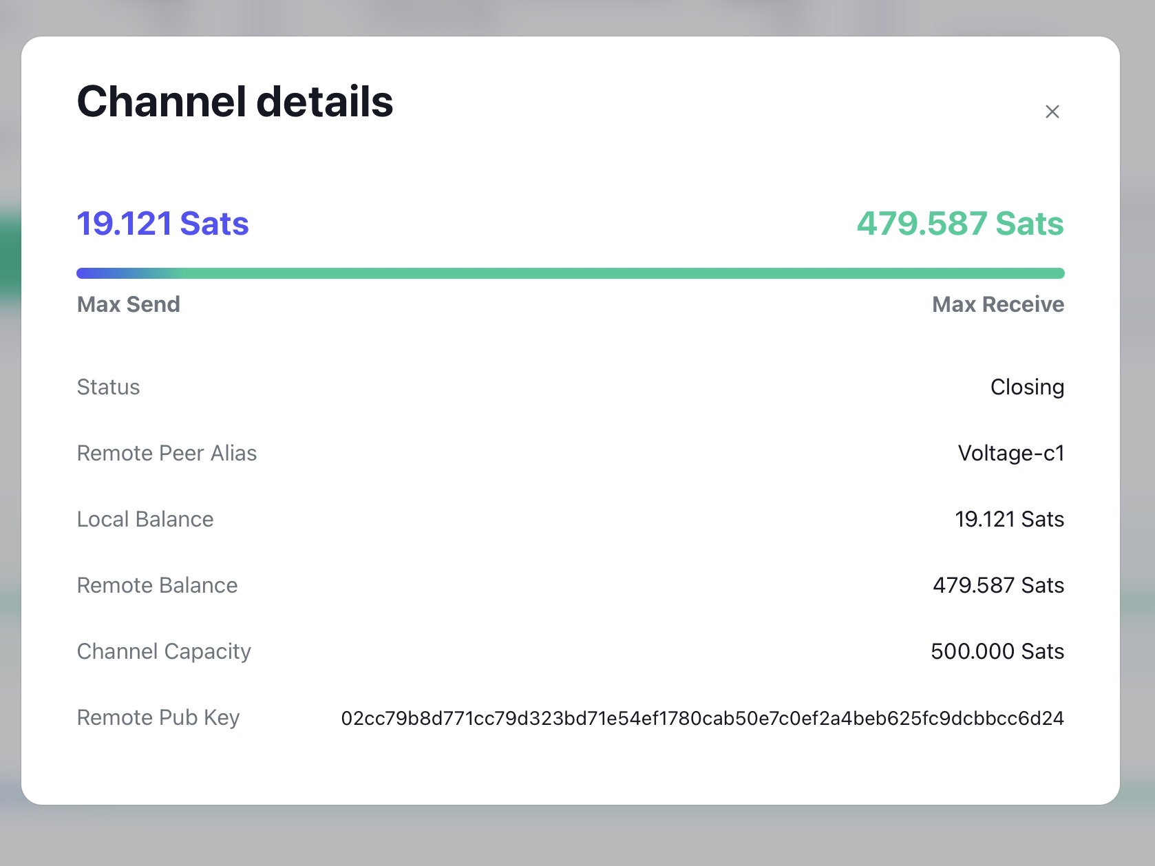

These 19k are confirmed to the address bc1qp5kr3tevkr7mzfhrc2kn8ykr46st6q6q0y4x56uukw4wdd27m6sqq8zuhs which is yours. The 330 sats anchors are lost / swept by a sweeper bot.

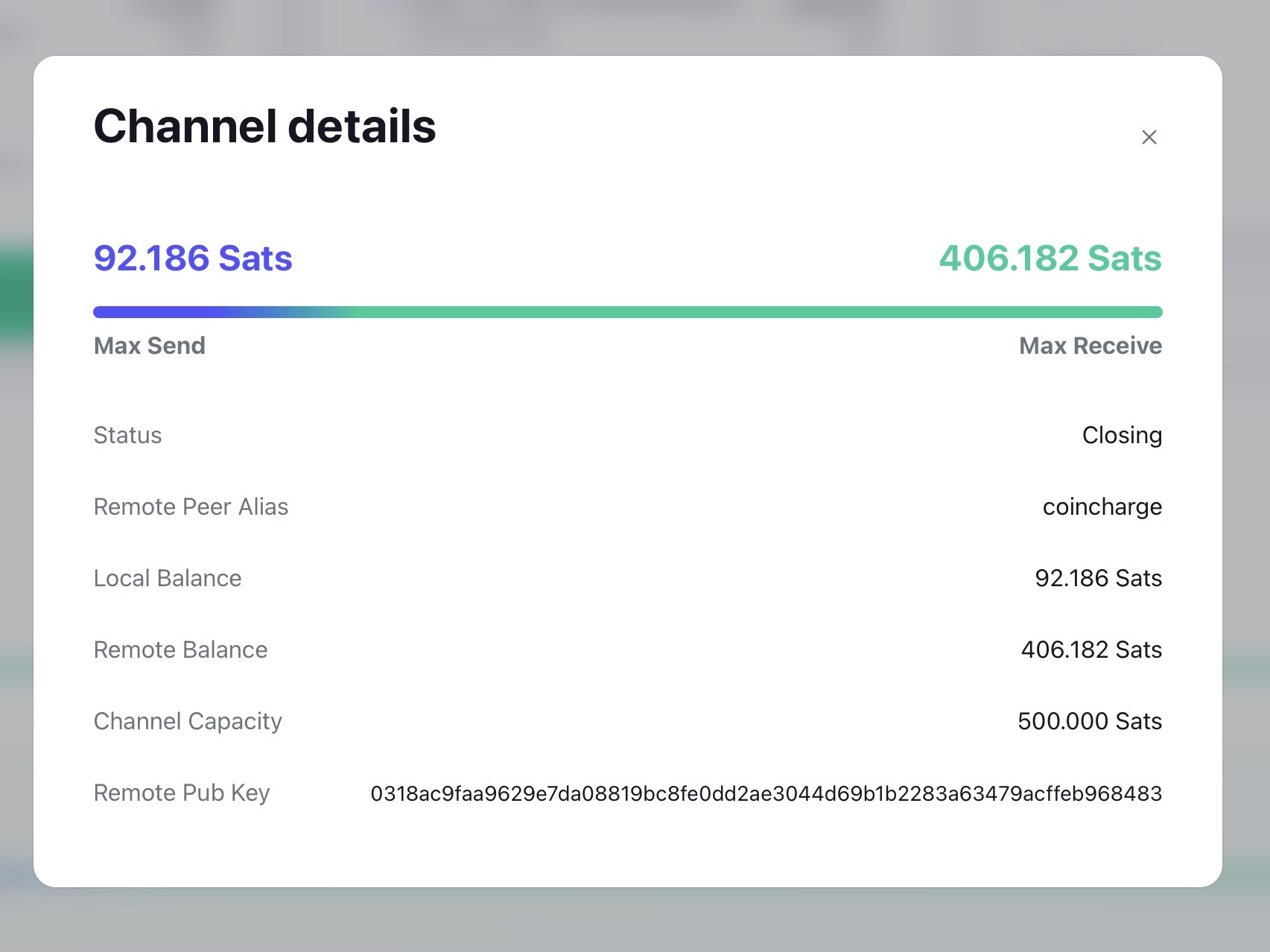

Same here, your address bc1q3ttup6em9gv42s6m9qq5w9dkcyunay2xt93cpkhxgktdh2vdd44scaklwu holds the 92186 sats:
Umbrel lightning shows closing, and the status posted before are pending Closing

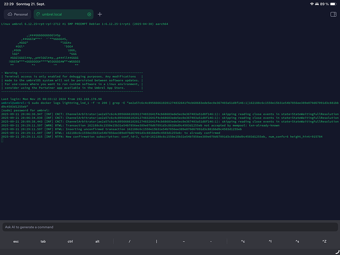

If you can, open two terminals! One to keep an eye on the logs, like
sudo docker logs lightning_lnd_1 -f -n 200 | grep -E "ae2a57c6c4c895666610201274832641f4cb68683ede5ec0e367403a51d8f146:1|162188c6c1550e15b31e54b7856ee389e070d67091d3c881bbd9c4503d1255eb"
and a second one to rebroadcast. This way, you will immediately see what LND takes in from your command here. Copy the first raw hex and append it to the command above, like this:
lncli wallet publishtx 0200000000010146f1d8513a4067e3c05ede3e6868cbf441268374122010666695c8c4c6572aae01000000007e932280044a0100000000000022002032aab8cf5696999c9ae69e2bdf5fcb1a9b7e67aeabd0a035d69c09b6589f675d4a01000000000000220020823230974434a7a1235cdd825e5d2bc53f9d933d5341c232e8392698f818c2ccb14a0000000000002200200d2c38af2cb0fdb126e3c2ad3392c3aea0bd0340792a6a6b9cb3aae6b55edea063510700000000002200203bc9bd70c698e4b885a31546bab504fc219382a9582bf6dd99bc0343d874e31e0400473044022051bd5727bd9685fab99a8e35705508638b7ac89c1e45fb3c4171a5eb5e79a6dc022048982d7e21fa677c3df171d953039d7a189ad0ea05931aab34613c2bd250138201483045022100957db4c8eff5cd46d7a2468fab55755a11a17b74428411396d9e5c7bfbab145a02205933aea1b1872867b601366a2edff1888c41fe073064fd5b7947283cd8674f0e014752210258892f416b3b19ec4429c7d74fdcd0af8cc5482f324254a512c2336a7e4a95ae21032f90f633bffa754e760ee79c8f060420c9aaf8e510414c97fcfbaa5b5cc1bdb552ae6e5f5720
In your terminal 1 window, you should see LND republishing the tx, ideally the sweeper waking up because LND recognises that these TX belong to you. Copy the results, so you have them in case nothing happens after a few blocks, and please only then share the logfile parts here.
I assume it’ll work, so firing the second in Terminal 2
lncli wallet publishtx 02000000000101beaf45131f1d83ed51ddc26d6414001a674cf1cff2d32dcc4076073f2d2c50470100000000f758d980044a010000000000002200202412a8b1dac9972e500a1be0df8bcabae4aa2bbf971da7e6cde75e9650144d994a010000000000002200204819867d9ae9f72246e298a701277764988915b76e9d47d406f0d4473229f8851a680100000000002200208ad7c0eb3b2a1955435b28014715b6c1393e9146596380dae64596dba98d6d6ba632060000000000220020f2b006318a4a9535d9a2f51b7c681d042638924ffe9179d467d1bbb4f576c72404004830450221009b1d34687d1cb8ad961db7c5aaae8362bee46a2d702bb3e0d063c2291544d9f202206f7d41a198ddeefbf06d19c455472fde0938d3f195a94efbbdf9fd1d5ca3b9a20147304402203cab113d75afa349d9fb6636d106990aa67db8568e533d475f698f6682aac4da0220746aed8e948cdedf8a08b0172e0eb997eb70942f968f68532174bbca8db3a50b0147522102e12bd5756d0799d00f51ae02785eb76aea5f03af6876a7350869c2fcf99ff140210316ea105618a274952f12dec0bec6c754851fa89e85be6306f44a1dcdacd26c6152ae1eb50820
Lmk if this works
The first one seems to be working
Cool. Check the UI if it’s still closing. Or lncli pendingchannels. If it still acts up, restart (never reinstall!) the LND container, or the whole node. This will cause LND to rebroadcast it again. Since it is now known as it’s own UTXO, it should work though.
I had to run like this: sudo docker exec -it lightning_lnd_1 lncli wallet publishtx 02000000000……..
But turned out I was chasing a ghost all day. The tx was listed as being in limbo but was actually spent.
