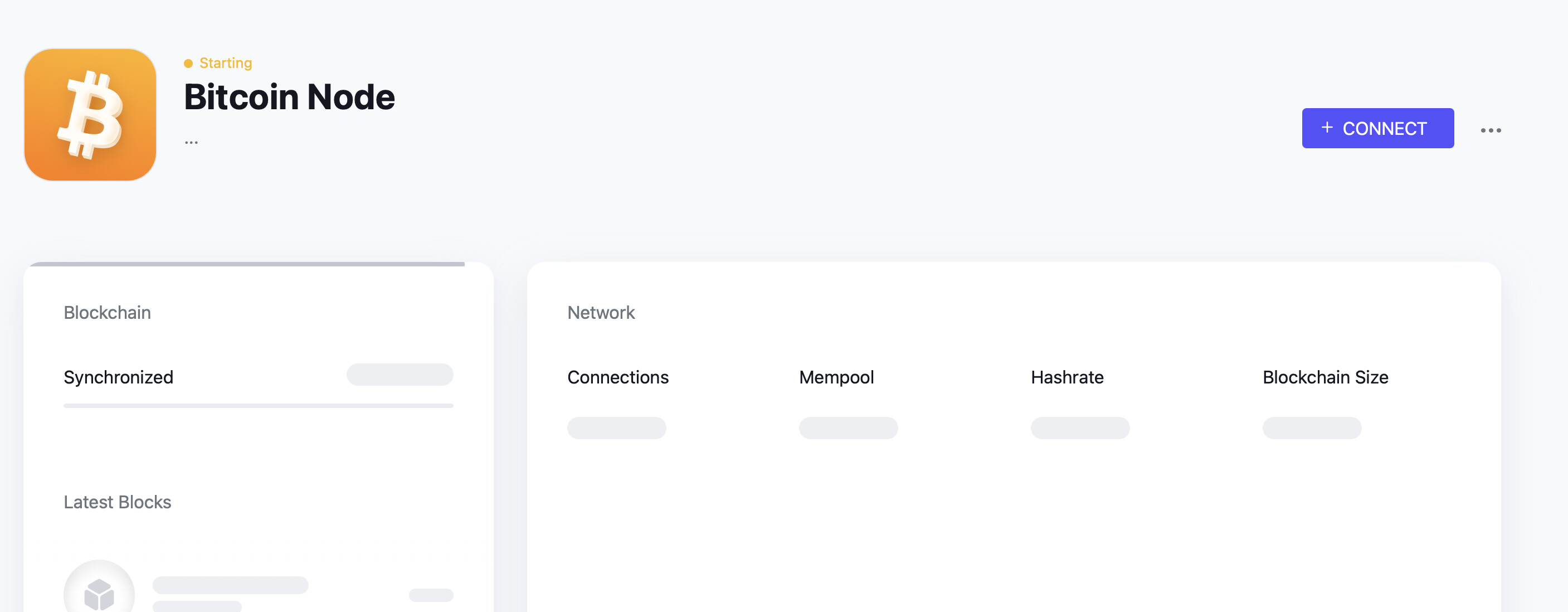

Hi All,
This is my fourth time trying to install a Bitcoin Node on Umbrel. Woke up this morning and it is stuck on ‘Bitcoin Node Starting’. I think it’s around 75% complete so far.
After some digging I get: ‘Error opening block database. Please restart with -reindex or -reindex-chainstate to recover.’ ChatGPT been helpful so far but I’m a little bit lost now. This is my fourth time of installing because it just keeps getting stuck, starting to lose faith!
Any help v much appreciated!

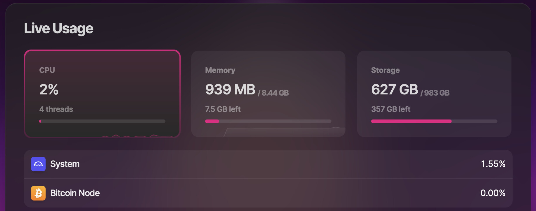

Thanks for the quick response:
  • SSD is currently at 627GB/1TB with 357GB remaining so plenty of space still
  • CPU and Memory look healthy too. No other services using memory
  • No power interruption that I’m aware of
  • SSD is brand new out the box
  • No other Umbrel services running
  • Software glitch - I guess so… Something has gone wonky and I fee like it’s more of a software issue than a hardware issue given the above?

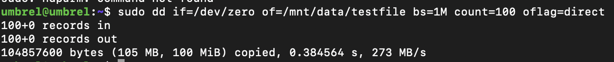

  • I/O Stress Test:
sudo hdparm -tT /dev/sda
This tests read speed. If speeds are very low (<50MB/s) or errors occur, the SSD or USB connection is problematic.
  • Write Test (careful, this writes data):
sudo dd if=/dev/zero of=/mnt/data/testfile bs=1M count=100 oflag=direct
If this fails with I/O errors, the SSD or connection is faulty. Delete the test file:
rm /mnt/data/testfile

5. Alternative SSD Health Check
Tried to unmount but don’t think it was successful:
IO Stress Test command not found
Write test seems okay & confirm removed
