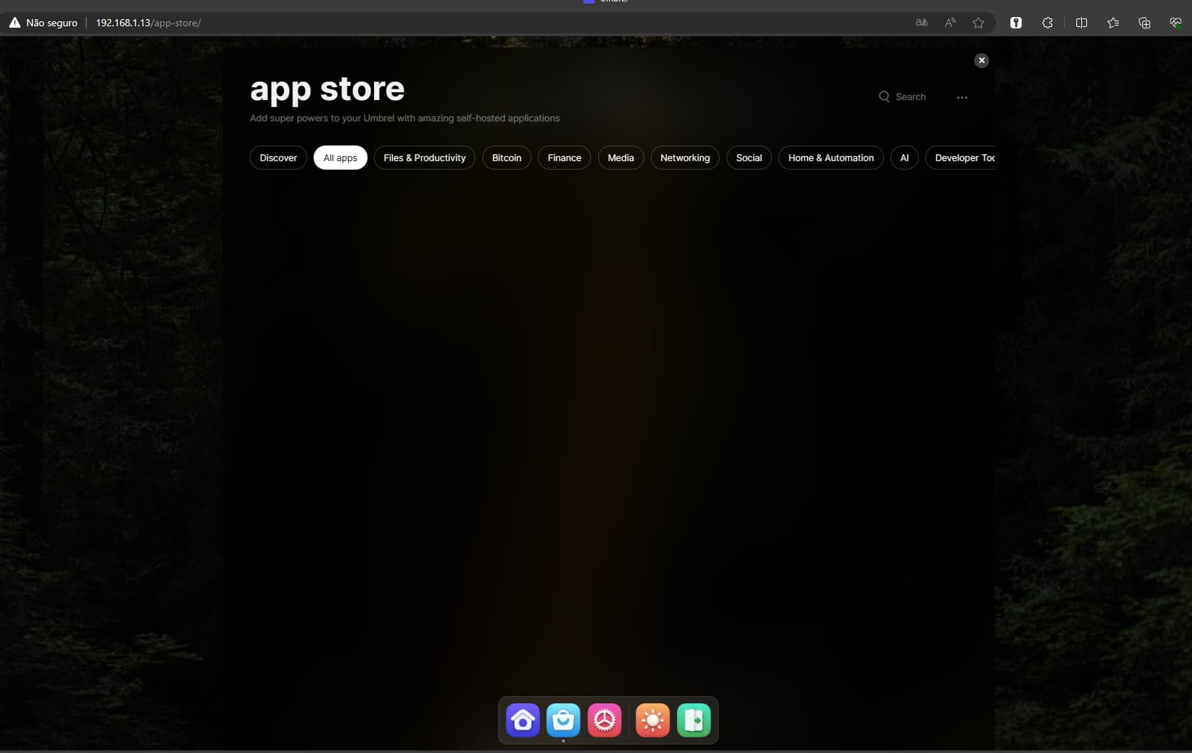

I installed everything with the script on my ubuntu server, and nothing appears in the app store. It looks like I don’t have permission: Failed to load resource: the server responded with a status of 401 (Unauthorized)

For the app-store issue, you should be able to resolve it with the following script:
sudo rm -f ~/umbrel/repos/https—github-com-getumbrel-umbrel-apps-git/.git/index.lock && sudo rm -f ~/umbrel/repos/https—github-com-getumbrel-umbrel-apps-git/.git/ORIG_HEAD.lock && sudo ~/umbrel/scripts/repo update

It’s applied the scripts there but it didn’t work apparently. Here’s the print.

I had this exact same issue last week on a freshly installed umbrel. I solved it by uninstalling and installing again.
