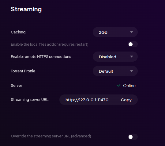

Honestly I’m new to container environment, and although stremio-server is up and running and accessible through the webui, I cannot get the Straming service to work (it’s always on error. Screenshot from 2024-07-09 11-56-34).

Solved it!
Everything is working fine. I missundertood how stremio service worked. You need to run it locally (in the computer u are using the webui) for it to work.

Once you run the webui (app.strem.io, or the servers ip:port) you need to got to seettings, and in the Streaming part
if for some reason, Server is ib error, you have to Enable override option and manually set the ip where the web service (computer you are accessin webui, and will ultimately play the stream) is running.

It seems to be just a visual bug. It shows as disconnected, but it is working.
Does it actually stream? Almost positive it won´t, with that on Error.
But you are almost there. You only need to install web service on the computer you are accessing web ui. if you did, maybe you forgot to run it. and if it is running, maybe you have the wrong port, or ip. if that is the case, enable override the streaming… and enter the url manually.
Where can I find the right URL? Yesterday, I couldn’t continue.
I don’t know what os u are in. I think the easiest approach is for u to go to stremio web (Stremio - Freedom to Stream) settings and check in the streaming section. If web service is working, it should be the ip stremio web is pointing at.
