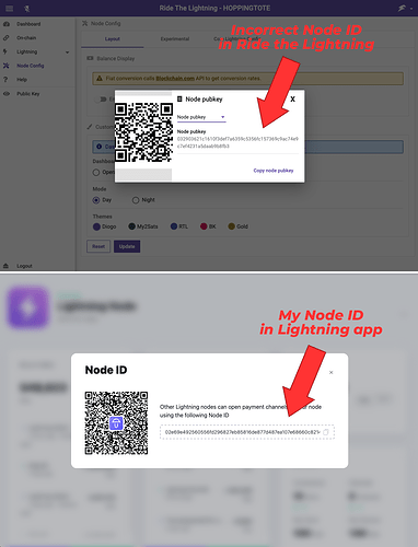

I noticed that RTL says “Welcome HOPPINGTOTE” at the top. However, my node’s alias is not HOPPINGTOTE, it’s SATOSHINAKA069.
When I click on “PUBLIC KEY” in RTL it shows a different Node URI/pubkey than the one I see under my Lightning Node app.

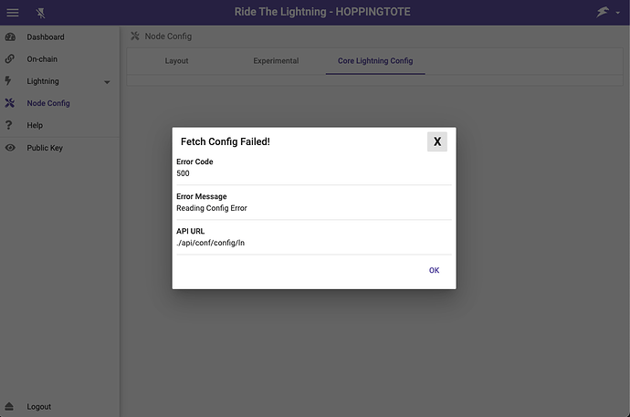

And if I click into NODE CONFIG > CORE LIGHTNING CONFIG there is nothing there. It says, Error Code 500 – Reading Config Error.

There are two separate lightning nodes running on your Umbrel:
  • LND
  • Core Lightning
The node pubkey you see on Umbrel and Thunderhub is your LND node. There are actually two different RTLs available on your Umbrel App Store, RTL (Core Lightning) and RTL. If you install and access RTL you would be able to view your LND node information.

Regarding the config file error, that again is a question best addressed to the umbrel team, as they need to fix the RTL configuration for core lightning. The core lightning config file path has to be correctly configured in RTL-Config.jsonto make this error go away.
