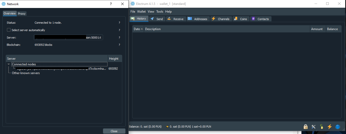

The Umbrel instructions are not enough I am afraid. Neither the youtube vid you are pushing folks on. By default it connects to plenty of available tor nodes. Even if you specify you node address to connect to. Should’t the electrum be connecting to only one node instead? I am using Windows 10 and electrum ver. 4.1.5. Managed to connect to my only node by using this guide: https://electrum.readthedocs.io/en/latest/tor.html#option-1-connecting-to-a-single-server

See attached (one server config through the electrum shortcut and default config of Electrum) what Electrum does if not run in the single server config for Tor. At least on my computer. Hope this is visible to you.
Yes, you may consider the Umbrel instructions correct but still not enough.
once you connect to your node, in the bottom right you will see a blue (not green) bubble.
That means you are connected to YOUR own node to validate your txs.
what Electrum does is also showing you the peers that your node is connected in that moment ads a bitcoin node.
That is perfectly normal and should be like that.
YOU CANNOT BE THE ONLY NODE IN THE BITCOIN NETWORK, you need other peers.
Change your perspective, you are missing the point.

I removed all the servers (recent-servers including) from the Electrum configuration and I am connecting to my node only. It desn’t push any other servers to the Electrum as you alure. BTW the servers on electrum didn’t mach my node peers at all. I have to agree with your rhetoric that I cannot be the only node in the BTC network but your reasoning sound like BS. I understand that my node is supposed to be the gateway to the BTC network for the Electrum and the node takes care of the peers not the Electrum. If I am wrong then how you make sure your node is the GTW if you are connected to 10 other electrum servers at the same time? Please advice.
You still don’t understand how this works.
Your node, like many others, is connected to other nodes, to sync the blockchain, usually 8-10 peers. All the time.
Your Electrum client app, will connect to your node, point to point, using local IP or onion address:port. So, from that moment your node is the only node that check and validate all the traffic between your Electrum wallet app and the rest of the Bitcoin network. Your node is the only one that facilitate this traffic.
So no matter what you are doing and saying, this is the only way.
That list that you see in Electrum wallet app is just a possible list of servers that you can connect to (as you connect to your node). That’s all.
But keep in mind: once you are connected to your own node, that list is IGNORED.
I hope you understand now.
