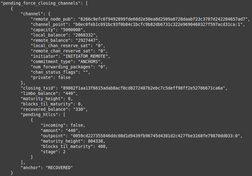

Hello @DarthCoin I’ve had recently a similar issue, I noticed that the channelclose has been pending for couple of months now and this is what I see in lncli pendingchannels
So I was wondering is there anything I could do with the channel? I see that there’s still blocks to maturity but only for those 440 sats, however no info regarding local balance of 2 068 332 sats.
The other peer says the channel is closed for him
Also when I check the closing tx for those 440 sats I this, few little addresses and mine 2 068 332 sats but when I check the address the balance is 440 sats.
Do I have to wait for all of those little transactions to confirm?
