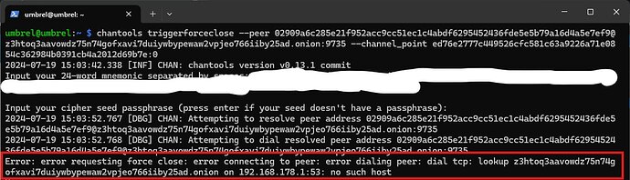

Well I fixed the channel point in chantools command, but didn’t help, you can see the result and error attached,
I was also asking for help in telegram Plebnet group. Unfortunately I have been told that there is no way I can get my fund back because the other node is also offline for more than 2 months! :frowning: This is really sad and devastating! I tried to contact the node on lightning network plus but no response.
I don’t know if there is any other way around to get my hard earned sats back! :frowning: :frowning:
I have looked up the pubkey, can you confirm it’s the right peer?
Can you check whether you’re showing up in their closed channel list? They don’t seem to have any channel online. That means either something’s wrong in their close list, or they have closed with you, which gives you the closing tx and presuming that your onchain wallet has the sats, your node just doesn’t know about it.

It looks like the following happened:
  1. The channel opening started on ‎2023-07-19, but with a too low fee (it was the mempool fee crazy time)
  2. It didn’t get confirmed within the 2 weeks (2016 blocks) maximum time. :point_left: You should have bumped the fees here
  3. Miners confirmation finally happened on ‎2023-09-29, but way beyond max-time. :point_left: You should have force-closed here
  4. Beyond max-time means that after 2 weeks pending open, your channel partner discards the channel, and it never really got confirmed. This is the reason for my previous post observation, the peer never saw the channel, all their channels are closed, because for them, you are not a channel peer
This seems to me like a fubar situation, and the only resolution we could ponder about is whether you have your channel.db, from whatever backup state available. Get your node online with that and see if LND force-closes automatically (since you come online with an old state).
Or, you reach the channel peer, but I wouldn’t know what they would be able to do, since they forgot your channel opening in September 2023.
Lastly, you can take my post and take it to the LND slack channel I shared earlier, or open a github issue in LND and see if Oliver has any other idea. But you may need to accept to
  • either find your channel.db
  • reach out to the peer and ask them for cooperative help (BitcoinAkademin.se)
  • or write off the 1M
I’m sorry
