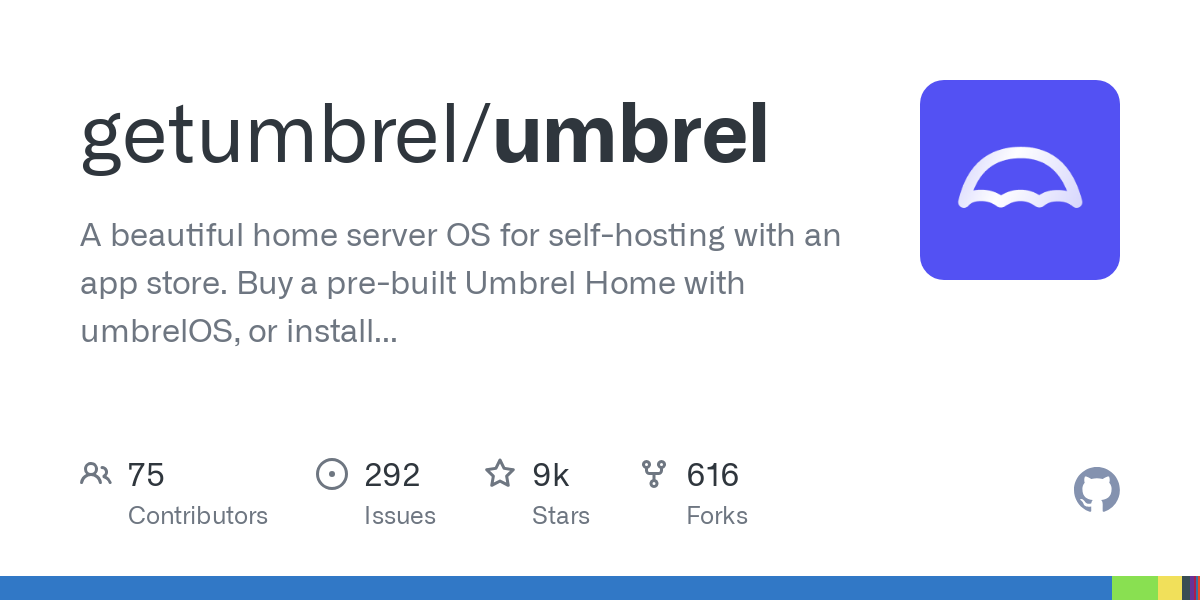

Oh my, what has happened? I just found the time to reinstall and went to the Umbrel HP, which now seems completely geared to selling the server hardware. just a slight mention of Pi5, no link to OS images…I am a little shocked. Found the Pi5 image on github but had to google for Pi4 images. Latest is V 0.5.4, my Pi4 ran V 1.3 through updates, though. Times have changed here, I guess.
Is there a Pi4 image of the current version or do I install 0.5.4 and update afterwards?
Thanks for any help!
Here you have them all:
Thank you, I could not find this for the life of me!
