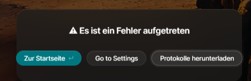

I have make the Upgrade vom Pi 4 to Pi 5, but it dosnt work. I have become this failure:
No matter what I click, I’m fromof this message.
@lukechilds I can give you the protocol via privat chat. I have use the original pi 5 charger.
I have restart the Pi, now it works. Sometimes you just can’t be so impatient :rofl:
