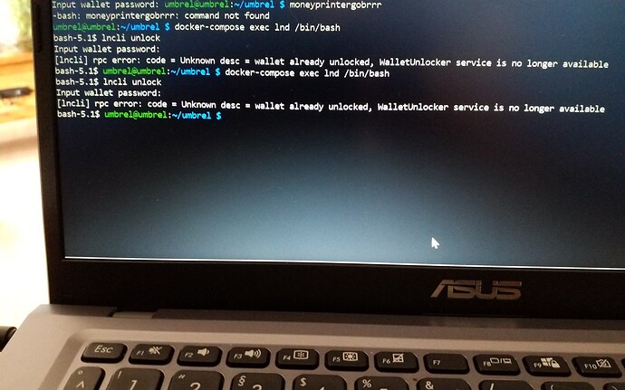

Problem: Incli unlock not found.
These should be 2 separate commands
  1. cd ~/umbrel
  2. docker-compose exec lnd /bin/bash
Now i login the passwort: moneyprintergobrrr
But i have an rpc error. Where is the problem?
Do you see the Problem in the LND Logs?!
