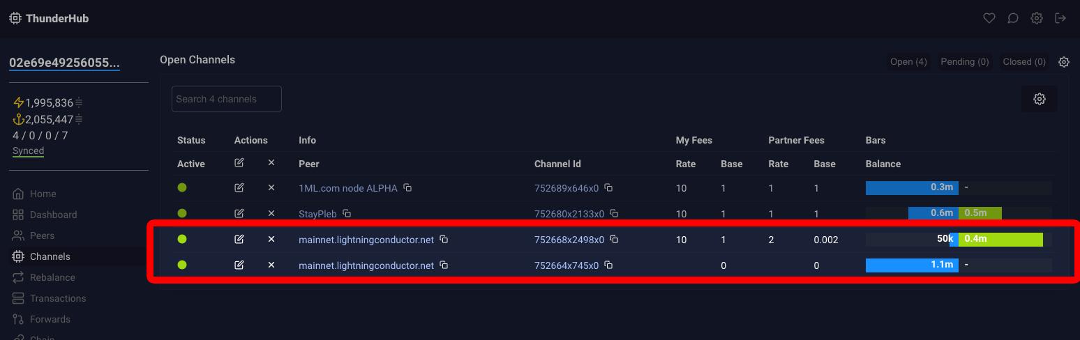

Just starting with my lightning node and I needed some inbound liquidity, so I opened a 1,000,000 Sat channel with mainnet.lightningconductor.net and they promptly opened one back to me with 500,000 Sats. Great!
I now have two channels open with Lightning Conductor (see image of my channels below). One channel has 0.4M INBOUND liquidity, the other has 1.1M outbound liquidity.
Problem is: when I try to send a payment using this channel Thunderhub only lets me choose the peer, not the specific channel. So I can’t figure out how to use the 1.1M outbound liquidity in the 2nd channel. If I attempt to send a payment over 50k using this peer, Thunderhub tells me there isn’t enough liquidity.
How do I move the 1.1M of outbound liquidity over to the other channel? Or am I thinking about this all wrong?

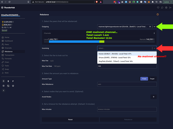

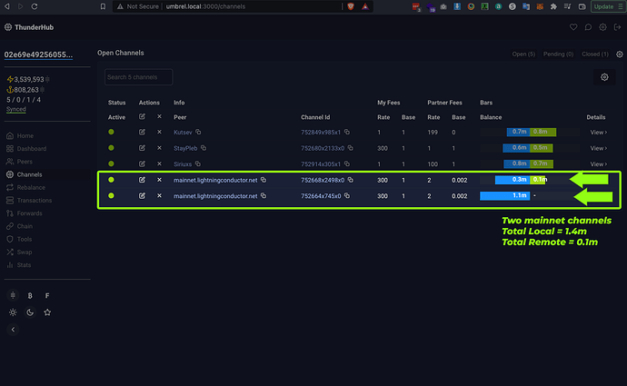

Thanks for the reply @Szek. This is all really helpful information. However, when I try to rebalance, Thunderhub only let’s me choose the Mainnet channel for Outgoing. For incoming, the other Mainnet channel isn’t an available option. At least when I attempt to rebalance, it appears that both Mainnet channels are being added together and considered as one single channel. See screenshots below…
Rebalance screen:
Open Channels screen:

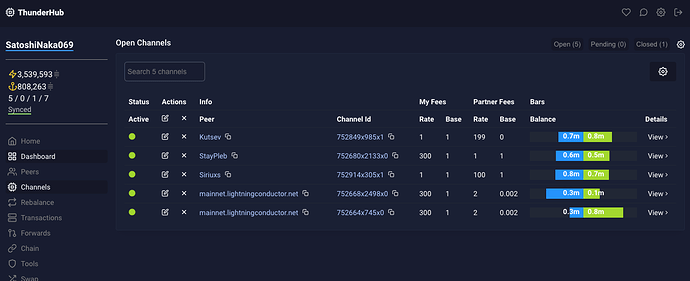

Incidentally, I also just installed Lightning Terminal and with that I decided to try to do a loop out with the offending channels. It worked and was surprisingly easy, even for me! With Thunderhub you can now see those two channels are balanced (or at least more balanced than previously)…
So do you think this indicates a bug with Thunderhub? I’m wondering if anyone else has run into this issue. Surely I must not be the first. It’s a nice little app otherwise.
