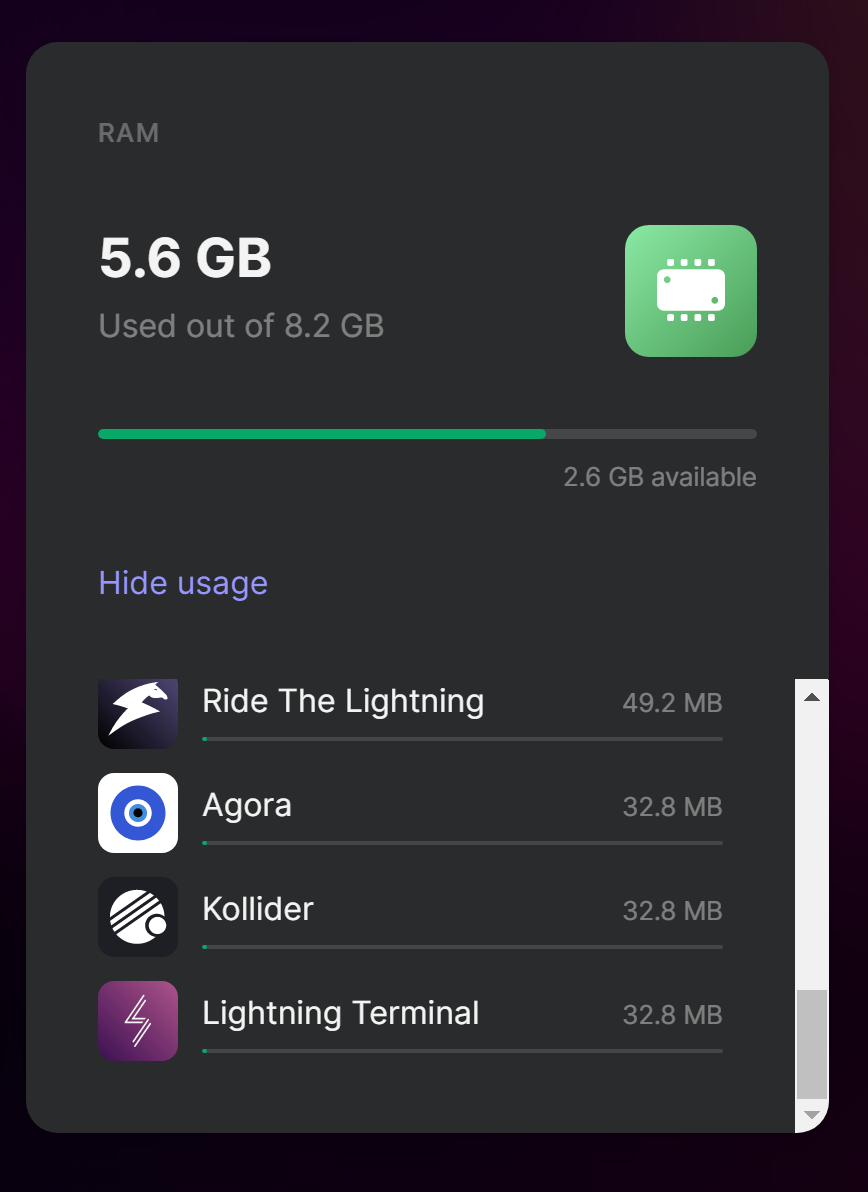

My 8GB RasPi uses 72 - 76% of his memory most of the time. After running the debug I found out that the system alone takes 46%.
How can umbrel even run on a 4GB RasPi (8GB is only recommended, not mandatory)?
Memory usage
          total        used        free      shared  buff/cache   available
Mem: 7.8G 5.7G 216M 415M 1.9G 1.6G
Swap: 4.1G 4.1G 0B
total: 72.4%
system: 46.4%
bitcoin: 7.6%

This is the top entry using htop:
Is this a standard task?

Very interesting tread. This is how it looks on my Pi4 with 4GB after 12 days.
@Floki, thanks for sharing.
How many channels does your node have and how much (roughly) traffic do you route per week?
None yet, since I haven’t set up any channels yet.
This is my situation. Node running from 1 year almost.
I had the same exact issue. Looks like a memory leak in DHCP client.
Solution: configure your node to use static IP configuration rather than DHCP. (the actual node network configuration… Not just on the router)
Restart.
It will go away.
