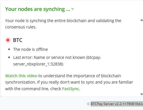

BTCPayServer BTC chain not syncing after update
After the upgrade to BTCPay Server v2.2.1+790616d2a on umbrelOS Version 0.5.4, the pay server is not in sync.
I was checking various troubleshooting articles, which suggest this is an issue with the container, perhaps with hostname/port variables of the Docker config file.
Also, the status of the NBXplorer container is “Restarting”.

In /umbrel/app-data/btcpay-server/data/nbxplorer/Main/settings.configEverything is default/commented.
umbrel@umbrel:~/umbrel/app-data/btcpay-server $ ping http://btcpay-server_nbxplorer_1:32838
ping: http://btcpay-server_nbxplorer_1:32838: Name or service not known
I don’t know what else to check or where to fix this. I run local DNS (BIND) and NGINX reverse proxy, but no changes there.
Any ideas?
