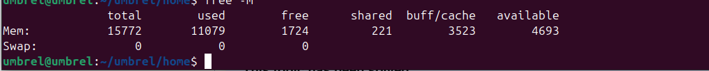

looking at the system, we can add a swapfile as there is not one on the OS side via ssh
I have a few programs on my umbrel, plus a miner on the OS side, so when I look at it
I need to add a swap file.
The drawback of docker is the programs you install are always running and taking up memory.
I have 16GB of ram so I am going to make a 32GB swapfile by:
sudo fallocate -l 32G /swapfile

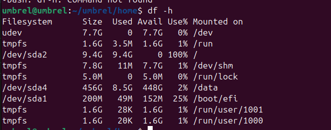

but I get an error that I have no disk space. Lets check the space free since this install took away the disk space from /
ok, looks like all the disk space has been reserved for /data which is the mount point for docker.
let’s try that again but put it in /data
sudo fallocate -l 32G /data/swapfile

now let’s see what we have:
Thank you for noticing we were running out of ram. I would have figured out when I did run out and it would crash my Umbrel install. One would think they would thought to do this when they created the install of Umbel.
