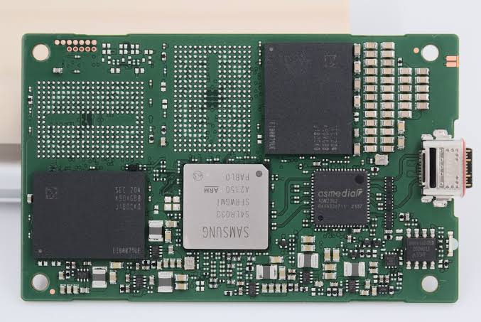

Sorry it was maybe not clear, the issue is with a Samsung T7 external USB-C SSD, the inside look like this: https://encrypted-tbn0.gstatic.com/images?q=tbn:ANd9GcSw2rM404QYAbhvbk7VYpyQVYIwJZqUAUp74g&usqp=CAU
So it’s impossible to mount it anywhere else. That’s why I think my only option is sending for repair.
I seeing people are having issues with this drive when I searched on the internet, and its associated with the connector on it only using one side/set of pins and burning up the cable. So I would try a different cable and rotate one connector side if it doesn’t work.
I tried the USB-C to USB-C cable, in all 8 possible positions (yes they are 8 with USB-C…) and the USB-C to USB-A in both way. Both cable works with the older Samsung T7 1TB that I have currently with my Umbrel install. I even try other cables laying around, on desktop and laptop computer, Linux Ubuntu, Clonezilla and Windows, the T7 2TB SSD is never seen.
