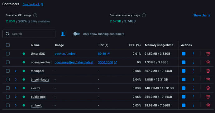

This is awesome btw. How can I connect clients like affine to the umbrel docker host ? I am running it inside of ZimaOS. The folks from BigBearTech used your script to create an app store entry for this….
