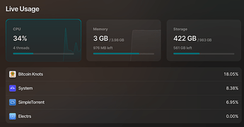

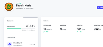

So, the blockchain is still downloading, almost 50%.
I guess the old blockchain was somehow deleted because the SSD has only used 422GB so far.
