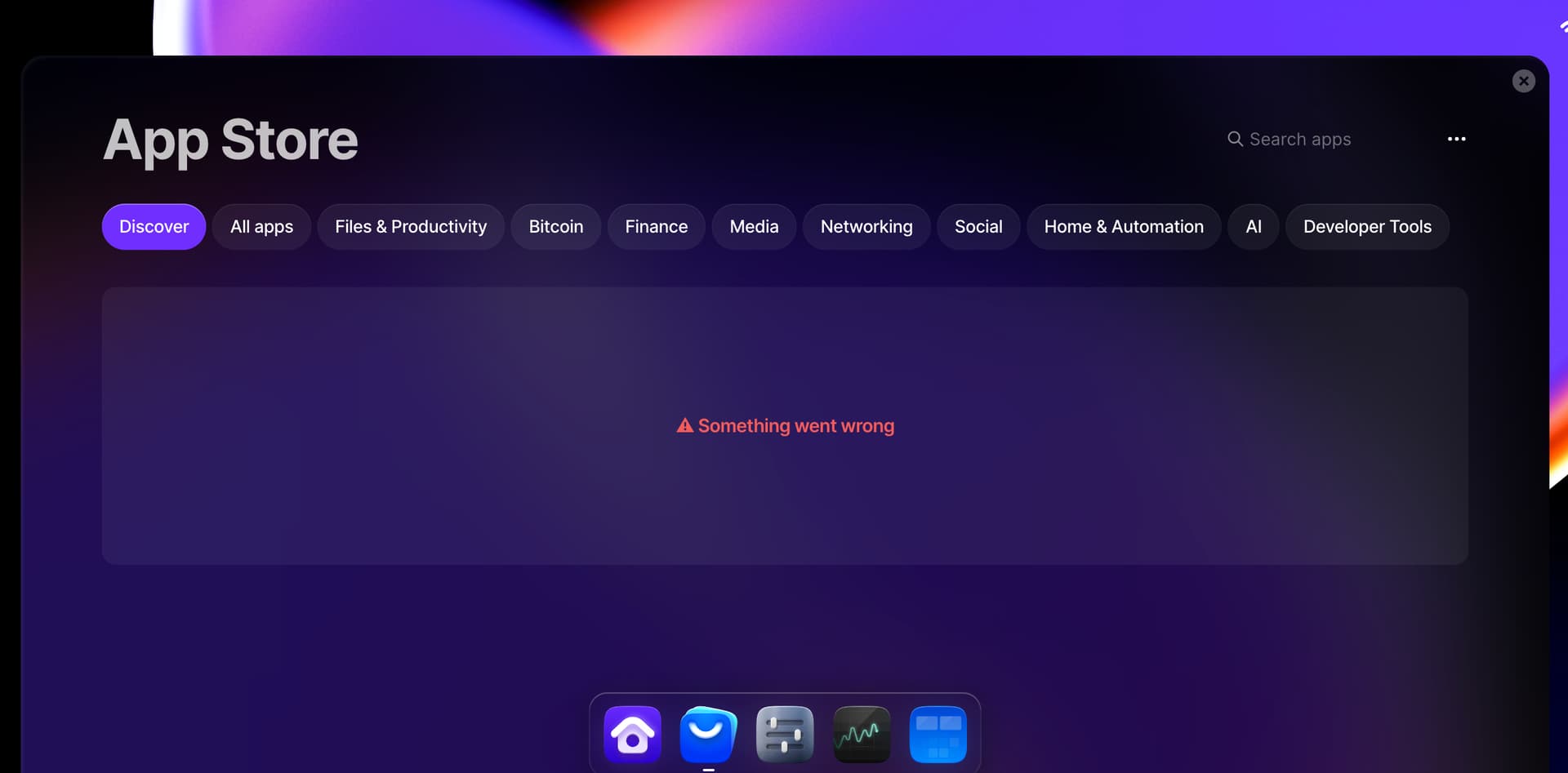

Issue with internet acces
i can ping succesfully - but app store not working and updates of os can’t be check
