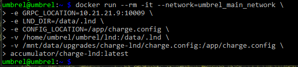

Hi - I seem to be stuck at step 6. Here is the output i see when running docker. Any guidance is greatly appreciated!
@The_Lorax Please see my above post above and let me know if you have any recommendations. Thank you!
Would you like to check the bottom line again?
-e GRPC_LOCATION=LND.10.21.21.9:10009
It seems that the IP contains an incorrect string. Why don’t you try setting it as follows?
-e GRPC_LOCATION=10.21.21.9:10009
Thanks for the reply @takebit
Tried what you recommended and it appears I have the same error:
In step 6, do I simply type:
cd ~
Or do I need to do something differently?
The error in the last line suggests that the charge.config file doesn’t exist, so we’ll use
I think you need to make sure that “/app/charge.config” is created correctly.

I believe cd ~ is all you need to type. That is what I did. It is just a safety check that you’re not in the wrong directory, it shouldn’t really do much at all.
