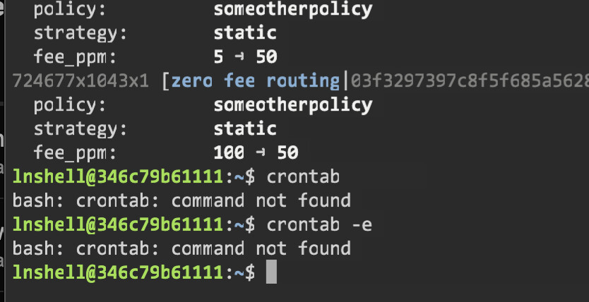

Sorry for the basic question… for step four, how do you create the charge.config file in data? I tried crontatb -e without success
What error did you get?
From SSH
and from lightningShell
Crontab -e has to be performed from umbrel SSH. Not from Lightning Shell. Lightning Shell does not include crontab.
