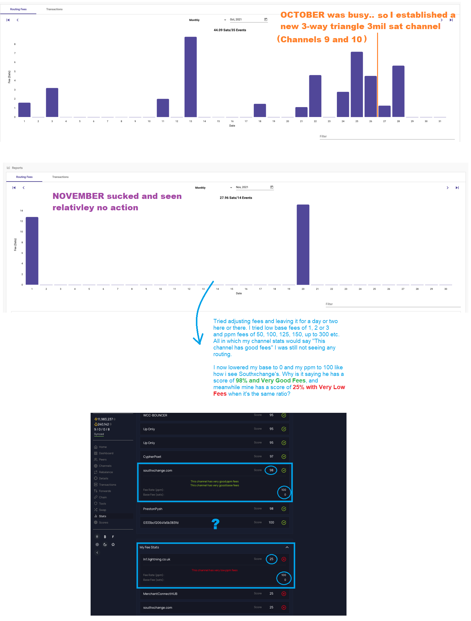

I believe I have a similar circumstance going on, not quite worthy of its own posting…
In October, my node was seeing a lot of action. Especially after opening channels 7 and 8 mid October.
End of the month, I opened another 3-way Channel on LightningNetwork+ for 3mil sats. (Channels 9 and 10)
Basically, all of November has been inactive. Side note, Channel 10’s Node has been completely offline since I opened to him for a month now. He’s having ongoing new router problems. Does this create a liquidity issue for me - causing my node not to perform as it should?
I wasn’t sure if this was causing any issues, or perhaps I had to adjust and lower my fees to get more routing thorough my node.
I am not quite sure as to what to set my base fee and ppm fee at.
Is there a standard or base minimum?
I have tried to set my fees similar to how I see other channels, but it still doesn’t seem right.
As you say: I’d rather not “play too much with what I do not know about and create more damage to myself or others” Please see the attached screenshot.
Any advice?
Thank you.
Your peers are disabling your channel.
