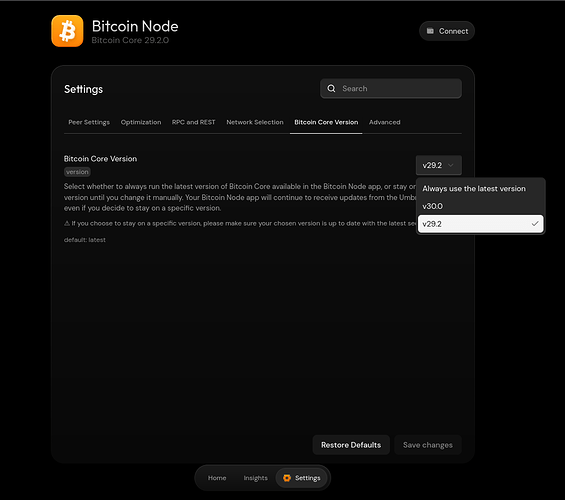

if i want to switch back to core 29.2 how Cani do that , in Umbrel App Store will it give me the option to chose the version of core I want to use
Reindexing chainstate I believe is faster. Looking at the logs your originally provided you should attempt that first. Instructions are the same but instead of reindex=1 you will use reindex-chainstate=1.
For using the 29.2 Bitcoin Core, it is in the application itself not the app store where you pick this. It’s in Bitcoin Core’s Setting menu.
