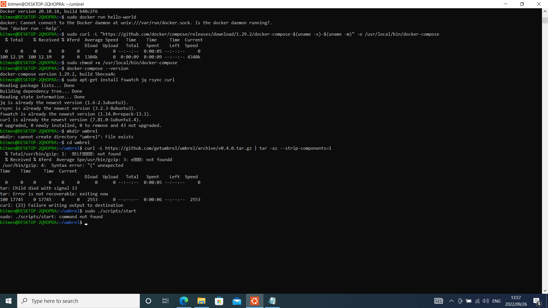

ok here it is:
It looks like there are already some files in your ~/umbrel directory
You should use an empty directory for the installation script to work, you can either remove the files in this directory or move them somewhere else.

Thanks again for all the help, it was looking promising, but then an error:
https://pastebin.com/mbL3AnMV
Morning, @Marcaday, hope you’re well. Was wondering whether you had managed to have a look at this recent error on Pastebin as I see the post has been ā€˜ā€˜hidden by community flags’’.
Hey @Bitmen, I hope you’re doing well!
I’ve taken a look at the logs and from my perspective, it might be an issue with the gzip package.

Hey @Marcaday, I followed your steps, but still no luck, here is the Pastebin link…please note this community chat doesn’t allow me to paste a link Pastebin but the reference is: 2v4JF46S
Hi @Marcaday, is there a way forward with Ubuntu or should I be looking at an alternative installation Operating System? Thanks.
I checked your last pastebin. It appears that the issue is that your were installing in Windows using WSL. This could be causing issues and errors:
Either use Docker for Windows, as the post above says, or (better) install on bare metal (using Easy2Boot or Rufus [Rufus 4 and 3.22 didn’t like Ubuntu server 22.04 so I used YUMI which worked great]) or a burned dvd. This assumes that you have another PC, and this older one will be your dedicated Umbrel server.
