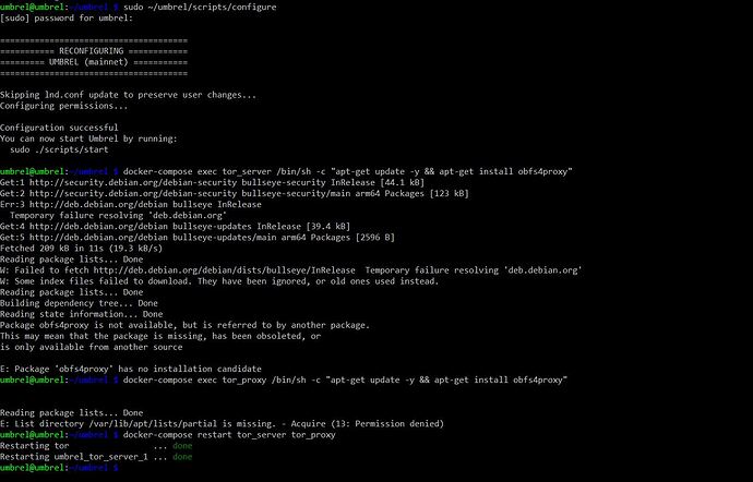

Unfortunately, the problem was not resolved!
Did I do the steps correctly?
