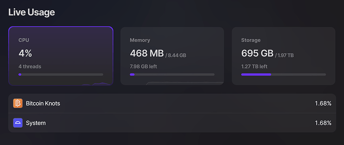

I have read that the RAM speed is a bottleneck area but the live usage of the CPU is always less than 10% and the RAM usage is only around 400Mb

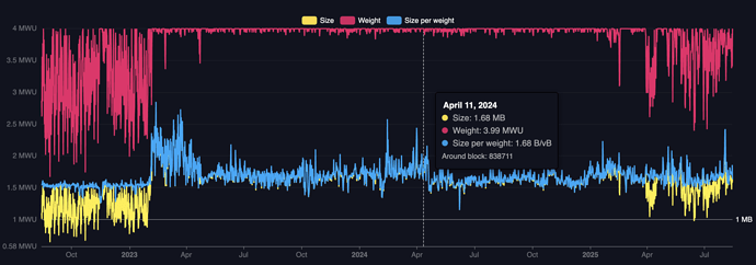

My average block download is increasing to 60 blocks per hour. I’m thinking that the blocks it is currently downloading and verifying have fewer transactions in them, or is it the block size?
The current block it’s verifying is 841517, which was around April of 2024. In the Blockchain.com graph below I see a dip in average transaction per block and average block size but in April 2024 it was obviously higher than any previous year.
But in this Mempool.space graph, it looks like the weight of the blocks is pretty consistent.
Which line would be the one to look at?
At this point, I am resigned to waiting for the IBD to complete and am not looking for ways to speed it up. But this experience has got me much more interested in the minutiae of it all.
Any thoughts on which of these graphs/lines is the one that corresponds to the speed at which the IBD is verifying blocks?

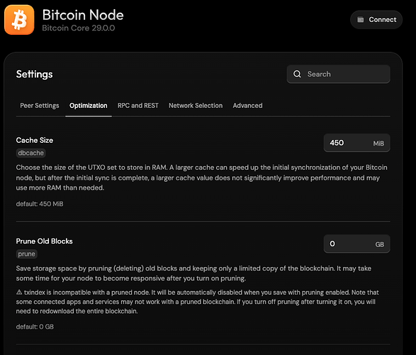

how much ram you have?
because you need to set dbcache properly in the.conf file
for 8Gb of ram
dbcache=7516
for 4Gb of ram
dbcache=3072
Hi,
Do you mean in settings, optimization, cache size?
Mine is set to default which is 450mb
